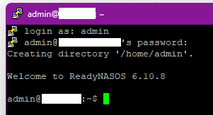

I really appreciate your comments, Sandshark.
Our known-good password worked fine for both WebGUI and SSH. (I don't know enough of Linux to do much without specific instructions.)
At one point, the WebGui briefly began working, with our known-good password, I was able to run a Disk Test.
That revealed Disk 3 tested bad.
Then the WebGUI closed or timed out. I was not able to browse it again. I could complete the login, but only to see the initial device splash page, if that much.
When I removed Disk 3 --- and before it was done rebuilding the RAID --- the WebGUI began working fine. It has continued working great. Known password is good for both SSH and Web.
I'm happy that our NAS is working. I think reinstall would wipe 3+ years of backups. Not good if can be avoided.
My original issue persists. When I use the same credentials with the Netgear RAIDar app, the error is "not a valid User Name or Password". See attachment. The password "password" doesn't work either.
I'm willing to live with that unless someone knows where a separate different admin password for RAIDar is located. I could change that password separately, perhaps. If not, que sera, sera. Or something else about RAIDar.
