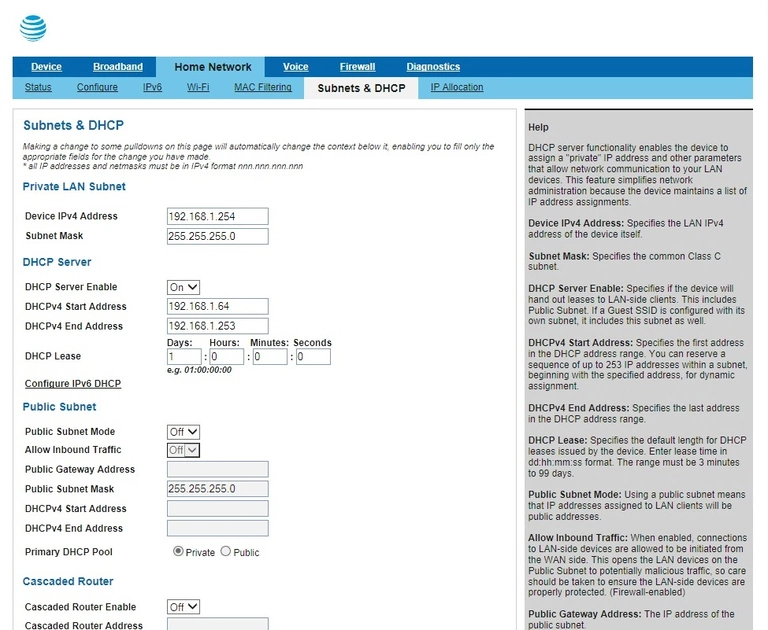

home network..this is a AtandT model BGW210-700
Device IPv4 AddressDHCPv4 NetmaskDHCP ServerDHCPv4 Start AddressDHCPv4 End Address192.168.1.254 router IP 255.255.255.0 DHCPv4 netmask On DCHP sever 192.168.1.64 DHCPv4 start address 192.168.1.253 DHCPv4 end address - StephenBJun 21, 2022Guru - Experienced User
Device IPv4 AddressDHCPv4 NetmaskDHCP ServerDHCPv4 Start AddressDHCPv4 End Address192.168.1.254 router IP 255.255.255.0 DHCPv4 netmask On DCHP sever 192.168.1.64 DHCPv4 start address 192.168.1.253 DHCPv4 end address You want to change the three 192.168.1.x addresses to 192.168.0.x (192.168.0.264, 192.168.0.64, 192.168.0.253).
These settings all appear to be on this page of the router web ui:
- cdugginsJun 21, 2022Guide
