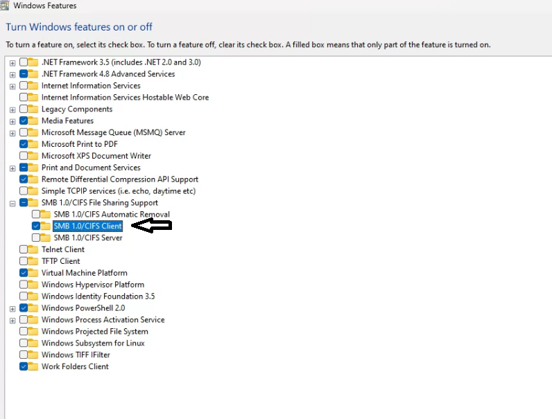

    Go into "Turn windows features on or off" on the PC.  Enable the SMB 1/CIFS client.
    Then try accessing the NAS in file explorer using the IP address of the NAS - putting \\nas-ip-address in the address bar.  Be careful to use the correct slash direction, and of course use the real IP address of the NAS.  If you are prompted for a user/password, then you can use the NAS admin account.

      I tried to enable the SMB 1/CIFS client as you suggested but I can't see where or how to do this when inside turning windows features on or off. I tried various iterations of "SMB", "SMB1" and "CIFS" in the search function (inside turning windows on or off) and it comes up with nothing.
        Odd, I see it on Win 11 home, and also my various Win 10 systems.
        Are you not seeing this?
