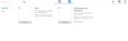

Could not install any application
Hi all! I have Readynas 10400 with 6.10.4 system, with 3 HDD (one 2TB and two 4TB). At first sight all is OK - I have full acces to shares, I can upload and download files etc. Yesterday my coll...

I think, there is possible that it is LogAnalyzer - but I have no possibility to unistall them by web interface. When I try to do it I am getting an information "There is no possible to uninstall the LogAnalyzer Application"
Is it maybe possible to do it by ssh?
I know, that this in not an easy operation and I have to be very, very carefull, but I need some more futher instuction. I do not want to brick my ReadyNas.
