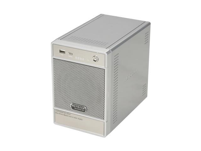

- AndreasSvenssonMar 10, 2016Aspirant
I'll try it, but this is the model that doesn't have a display. Like this: http://images10.newegg.com/NeweggImage/ProductImage/22-122-014-04.jpg
