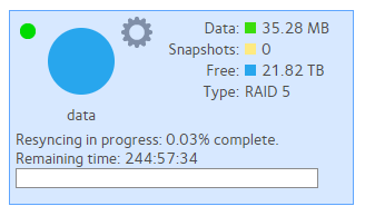

From scratch; 'resyncing' new drives is taking a week, should I be concerned?
With a ReadyNas 104, and 4x new 8TB disks is this normal? Am I really going to have to wait more than a week for it to finish syncing? My understanding is if I try to use the drives as-is whilst syncing is that 1. it will be very slow and 2. it will lengthen the resync process even further. Is that correct also?

    What model drives are you using?
    244 does sound high.  Though the RN104 was the entry level NAS, and is slower than the other OS-6 models.  The estimates aren't always right btw.

      I am wondering if they are SMR, which could account for it.
      Although I'm not seeing a posted build time for 4x8TB on the RN104, there are a couple of times posted for other disk configurations on RN102 and RN104 models.  Though volume build times definitely will vary for different RAID modes (and for different disks), you can roughly estimate build speed by dividing the total disk capacity by the time it takes.
      When I apply those estimates to your system configuration, I end up with approximately half the time you are seeing (ballpark of 120 hours).

      The RN100 speed is definitely limited by the CPU/RAM, and not the disks.
      I have some old logs that show volume build time for both the RN102 and the RN202 with 2x1TB Ironwolf disks.  This was done at about the same time, using the same firmware.  Volume build time for the RN102 took about 7 hours, the RN202 only took about 2 hours.  The RN202 build speed was therefore about 1 TB per hour, the RN102 was about 280 GB per hour for the same disks.
      FWIW, just applying that 280 GB per hour speed to your 4x8TB configuration yields about 114 hours - that was one of the data points I used to guestimate the time your build might take.

      To be more clear on the potential problems:
      • RAID sync times (as you already see) will be much slower on the RN104 than other other models.  Disk Scrubs will also be much slower.
      • The limited memory could also result in out-of-memory (OOM) crashes.
      Long RAID sync times are of course annoying.  But more importantly, the volume isn't protected during the sync.  So longer sync times also make the volume more vulnerable - the odds of a second disk failure happening during the sync go up some, as do the odds of a power failure or some other event disrupting the sync.
      OOM is IMO more concerning than the RAID sync time, because any crash risks an out-of-sync volume due to loss of cached writes.  You can lower the risk of OOM crashes by being careful about the services you enable on the NAS (and the apps you choose to install).
      For instance, don't enable AFP, NFS, or even FTP on the RN104 if you don't really need those services.  Similarly for ReadyCloud and other cloud apps.  Plex can potentially lead to problems - it does use quite a bit of memory.  So if the NAS hangs up when Plex is scanning your media library, then consider moving Plex to a PC (mapping the NAS media shares to one or more drive letters).
      One option to work around the RAID sync times is to use JBOD (with four 8 TB volumes).  Then there is no RAID sync needed - but also no RAID redundancy.  I've done this on both the RN102 and the RN202, in order to max the capacity.

        This is a good point. Cigoler what model number are these drives?
        The concern is pretty much what StephenB said. The low memory and processing power will make this unit much more susceptible to OOM conditions and crashes related to resource starvation. The bigger a volume is, the more ref-links, metadata and so on, that the filesystem needs to keep track. All which required memory and CPU. The main concern is that with a large volume, the NAS will buckle and the potential for filesystem corruption will be higher, IMO. Hence, keep up-to-date backups of things that matter :)
        This unit was released around 8 years ago. The CPU is significantly outdated and it is still only a single core ARM. Couple that with 512 MB of RAM and you really are limited. I would echo what StephenB said, to keep all services at a minimum. Turn off everything you don't need (like AFP, NFS, etc.).
