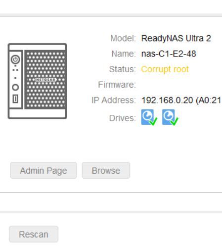

Getting status message Corrupt root
Hi. I have used my ReadyNas Ultra2 for something like 2 years. And now one HDD is broken. I changed it and then "Status: Corrupt root" Tryed OS reinstall --> and that diden´t work (same S...
VolvoSkinn
Feb 10, 2016Aspirant
When i boot the RNDU 2 and press RESET. The led is behave as it is specefied.
I chose the factory deafault. Then press reset and i get a rebot.
Then i get this
After somehing like 30 sec the sound form the HDDs are gone.
And in the picture i have klick on setup. I can pick what ewer here. ( i have tryed them all )(3 different first expand vol recomended and the i tested RAID 0 and then, wht the **** i go whit the ERASE)
But allways i end up whit this. After aprox 20 sec
I cant access the IP adress in an internet browser. I cant se or communicate whit it in any way. I need to go to step one agan. And reboot over and over again. Please help me

- VolvoSkinnFeb 10, 2016Aspirant
- mdgm-ntgrFeb 10, 2016NETGEAR Employee Retired
There were two problems here.
1. The firmware on the flash was corrupt, so the factory reset would have failed as a result of this. I fixed this. Whilst USB Boot Recovery could have been used to fix this particular problem there may have been some side effects.
2. One of your disks appears to be bad.
