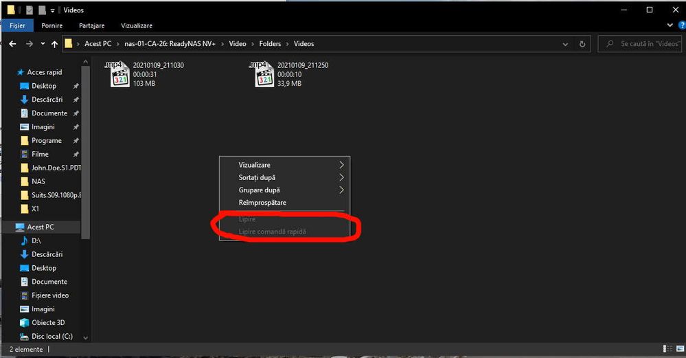

Under Windows I managed somehow to "mount" the NAS in my computer, I can see it, I can access and read it but no write possibilty.
And when I want to access it from "network" window, it gives the already classic error 0x80004005 which, right now, I'm struggling to solve.

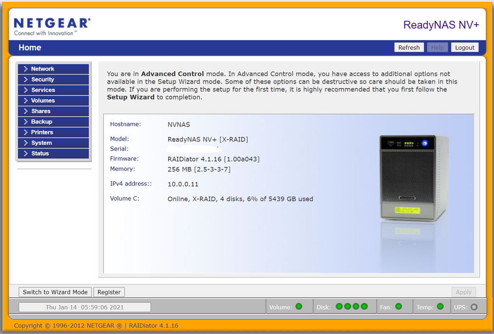

You should see a log-on popup, and after you log in as admin you should see something like this:
RAIDar should be able to tell you what firmware is on the NAS. If the firmware is very old, it might not be compatible with current browsers, so it would be useful to know what it is running. https://kb.netgear.com/20684/ReadyNAS-Downloads
Yeah, that is interface, in Ubuntu. In windows it just shows a bunch of `things`, as showed in the first post.

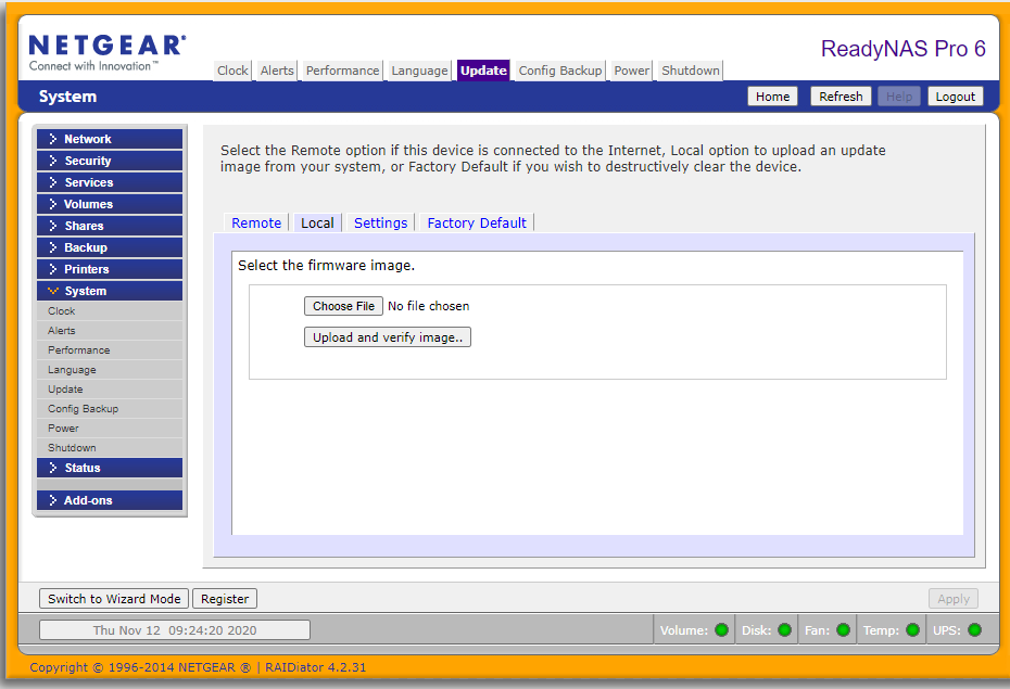

Download 4.1.16 from https://kb.netgear.com/000038792/RAIDiator-Version-4-1-16-Sparc and extract the image from the zip file.
Then manually install it from the web interface (using the "local" tab):
You'll probably need to click through a registration offer to get to this page.
BTW, there were changes to the partitioning between 4.1.6 and 4.1.16. You need to do a factory reset after the update to get them. But since you'll be doing a factory reset anyway with the real disks, that's not a priority.
Check again on the admin web interface issue in Windows after you upgrade the firmware.

I managed somehow to map the network drive in my computer, but when I access it, I only have read privileges:
