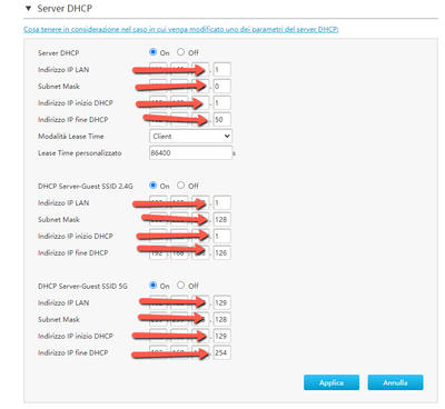

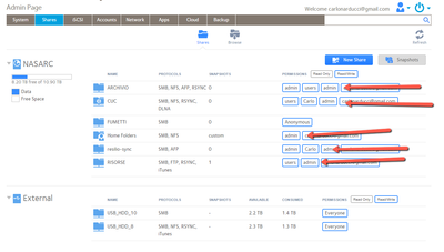

Changed nas name, tried to connect again from network on pc and no way still password does not work
in this way I can access
so i cannot map single shortcuts or nas partition
