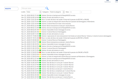

need to solve hdd failure on a Nas RN104
my 4x 4 tb rn104 nas is having problems a couple of days ago mechanical noise and after 20 hours or recovery a second failure and again 20 hours of recover this is the report then the second fa...

It looks like the resync failed on disk 4 (per the first screenshot). The second one says a disk test is in progress, it's not clear what the timing is. However, it looks like disk 4 might have failed. The best way to confirm would be to power down the NAS, and connect the disk to a Windows PC, and test it with SeaTools. You can connect with a USB adapter/dock if you can't connect it with SATA.
