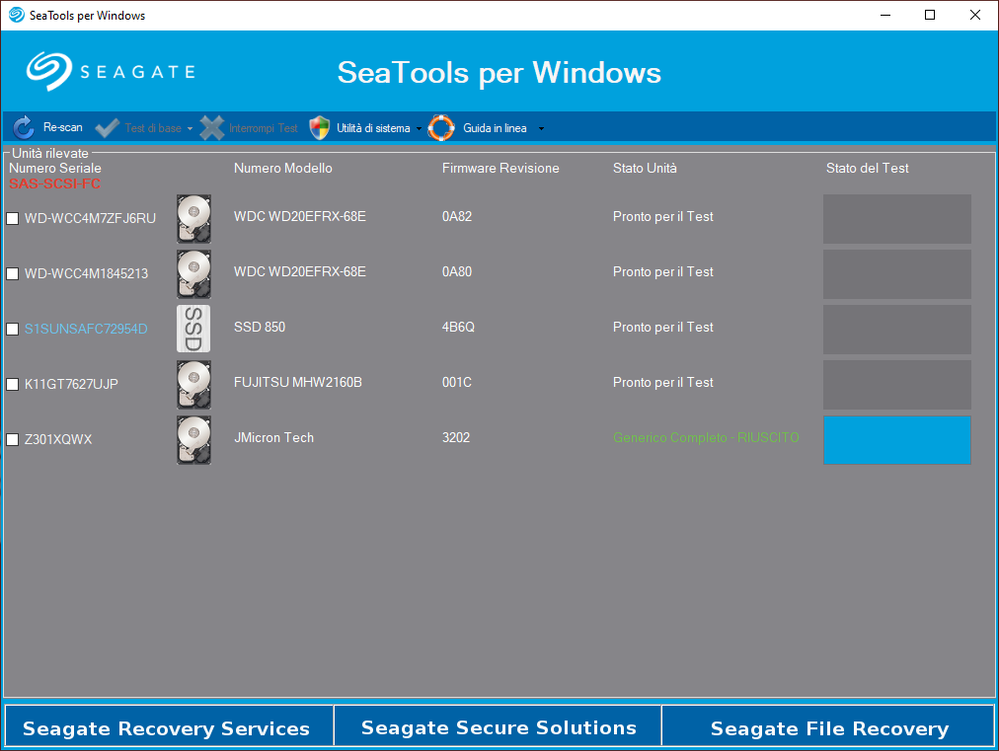

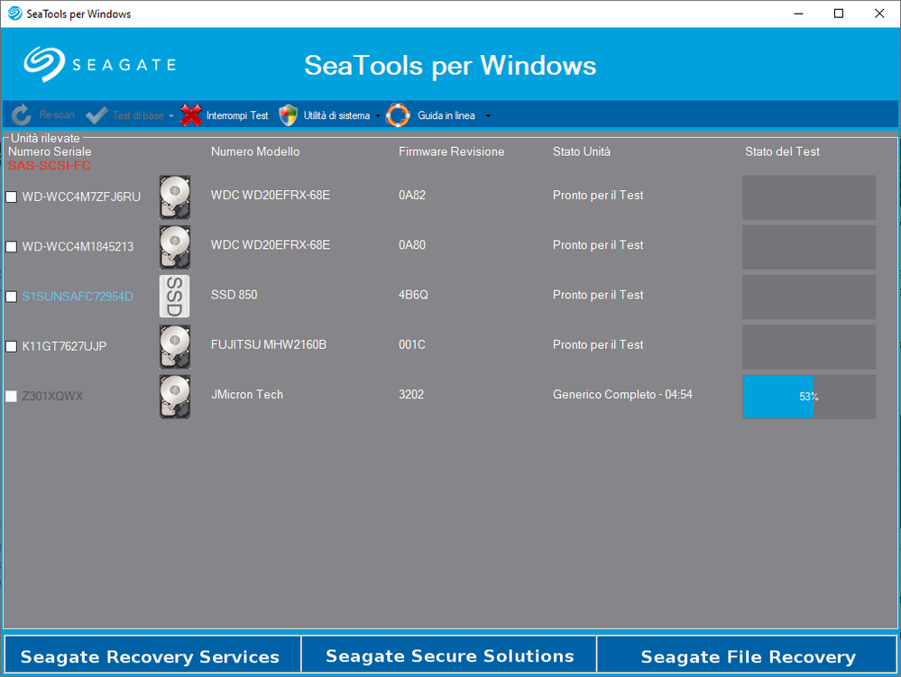

- carlockiNov 24, 2020Luminary
i first error I found seatools with message error maybe for overheating
now is still testing deep
- carlockiNov 25, 2020Luminary
It seems deep scan on bay 4th showns no problem
- StephenBNov 25, 2020Guru - Experienced User
Do you have a question?
I am unclear as to whether Seatools was testing your old disk or a new one.
THE OLD ONE 4th bay.
no errors...
deep scan 20 hours

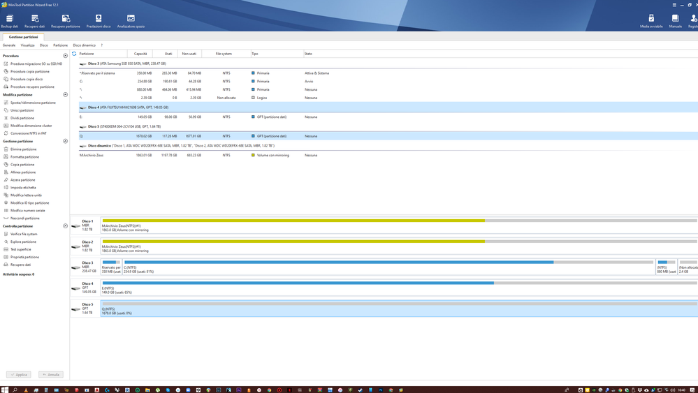

why on this new hdd i cannot do a partition of 4 TB and just one of 1,7 Tb?
The NAS will format and partition the drive. There is normally a 4 GB partition for the operating system, a small partition for swap, and one or more partitions for the data volume. The size and number of the data volume partitions depend on the RAID groups that are in the volume.
this one is not the nas hdd is the external antec unit hdd and i cannot split it in 2 TB volumes 2+2=4TB barracuda..
trieud everything
I don't why you need to split it.
But normally you'd right-click on the volume and shrink it to 2 TB. Then right-click on the unallocated space, and create a new simple volume.
it does not work
it is a four TB but it shows just an hdd of 1,679,02 MB
How old is the PC? Some very old PCs can't handle GPT formatting (and the older MBR formatting is limited to 2 TB).
it is na i7 with wondows 10
it was about add the hdd direclty with the motherboatd
now it works
i ma formatting
