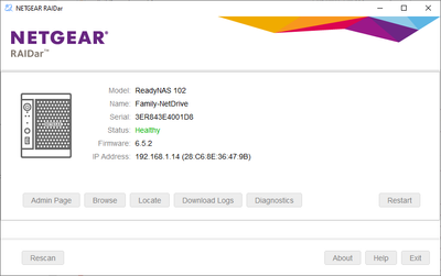

First download RAIDar 6.5 from this page and install it on your PC:
Scroll down the web page until you see this section:
After you install RAIDar on your Windows PC, run it, and see if it finds your NAS. If it does, you'll see a page that looks like this:
It'd be useful to see exactly what your page says, so posting a screen shot would be helpful.

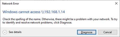

Second, open explorer and enter \\nas-ip-address in the address bar as shown below. DO NOT CLICK ON THE ICON. Make sure you start with \\
When I do that, I get a list of shares. I've removed most of their names in the screen shot above. It'd be helpful to know if you see a list of shares, or if something else happens.

ok thanks. I had to load java first but I got the 6.5 to run. I get a screen that shows the NAS is healthy but if I browse the data if still gives me no data. I still cannot browse the admin page via //IP.
- BenReddMay 21, 2023Aspirant
If I try to click on Diagnostics it asked me for the user name and password which I have correct and tells me it is wrong. Can you factory reset password without erasing the disk data?
Looks like the NAS is running 6.5.2 firmware, so a bit newer than 6.4.1.

If I type \\<IP> in File Explorer I get this error:
If I type \\<IP> into a browser I get "page cannot be found" from browser.
If I type // <!P> into a browser I get "page cannot be found" from browser.

I am still confused on what you are seeing with file explorer when you enter the IP address (prepended with \\) in the address bar.
It sounds like the system is opening the browser. which suggests you are using the wrong slash.

I mentioned in the reply prior that if I type the \\ <IP> in the File Explorer the browser does not open but I get this error:
Thx. FWIW, you said you got a "This site can't be reached" message, which is not something I've seen with file explorer.
I wasn't sure if you meant "internet browser" or "file browser" in your earlier reply.
