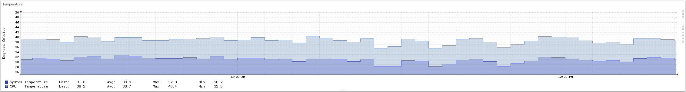

What does your temperature graph look like? FWIW, here's mine (526x - using the balanced fan setting):
As you can see, the temps will vary depending on activity, and that of course will affect the fans. I upgraded two disks a week ago (and you can see the higher temps at the very beginning of the graph when the second one was resyncing). On May 13th I was running rsync to transfer about 3 TB of data to another NAS. The small daily spikes after that are when the daily backups run.
With little/no activity the fan runs at about 860 rpm.

I've attached a screenshot of the temp gauge. It only goes back a day, since that's how long it's been on. I'm assuming the big drops correspond to the fan speed spikes, although there have been a whole lot more spikes in the past 24 hours than drops in the graph.
Usually the fan would run at about 1050 rpm (balanced setting), but the spikes invariably take that up to ~3200 rpm for about a minute. Both the old NAS and this one are in the same room, although the new NAS is set on a shelf about 20cm higher than the old one. The noise it makes is purely the fans (it sounds like it's trying to take off), no vibrations or echoes. If anything, the new NAS is in a less confined space than the old one, which should reduce both noise reverberations and heat retention.
- My thinking is that the temperature sensitivity is set way too low, causing it to exhaust like crazy whenever the system reaches 32C (and CPU about 42C). Looking at your graph, and assuming that the drops correspond to fan speed increases, I conclude the follwoing:
Your system can handle temperatures at least 5C degrees above what mine can; - You only get about one spike a day (whereas I get them much more often);
- Overall, your fans expel heat more effeciently, seeing as temperature seems to stay around the same level during the day.
