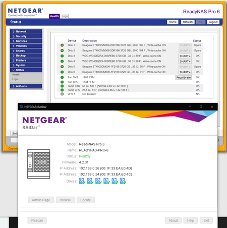

Just to be clear, I swapped the first disk and it went to a spare after say for a day or so that recovery was 6% and was not moving. On the third day the NAS advised me that drive 3 was failing and needed to be replaced, so I did, it immediately went to spare no recovery was started. At some point within a few hours, drive 6 started showing up as a spare? Drive 6 log on the web-interface showed it wanted to be replaced as it was failing as well.
I work in a data centre, in my entire life I have never seen a three-drive failure, never ever. The two disk failures are rare but have had some over a year and very common is one disk failure on any raid. I believe there is more at play here. Having said that, for the last 5 days it all stable with the layout in the photos, but cannot access the data and drives sitting on spare.

I replaced the drives back to the original slots and this below I believe means "all gone" So much for RAID 6
Whilst the drives 1 & 2 showup as Dead, they are actully okay, in the sence that RAID can format and use these two drives.
