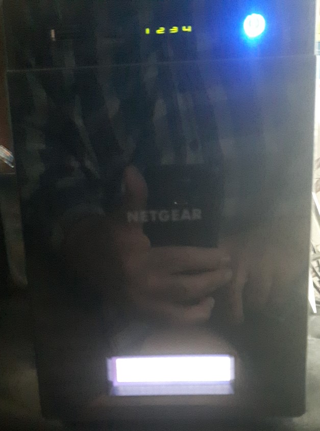

ReadyNas rn204 won't start up
I have a used RN204 with 4 2TB WD drives. When I power on it will start up and stop with this. (view attached jpg)
I connected up usb-serial, using putty, recorded this:

The reason I thing the environment varaible has issue, with usb/serial attached, through putty, stop bootup and get to "ALPINE_DB> " input stage. If I just type in 'boot' it will boot up and pull an ip. I can log in and work with it at normal. It is at latest level of ReadyNas6. I can access it over my network just fine. If I restart or power down/up, I am back to square one, and am unable to access, never pulls IP from router.
Can anyone help with where/what is wrong with boot?
