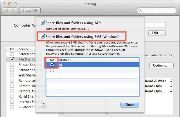

Ended up being pretty straightforward. In MacOS Preferences/Sharing, the File Sharing must be clicked ON, and the shared folders to be backuped need to be listed with permissions for whatever user ID you are using.
What I missed was the Options button. Share files using SMB must be clicked on (which it is by default) [In Big Sur OS AFP is no longer an option; it is in older MacOS.] --->> Then in the Windows File sharing section I needed to click the account I'm using (then it asks you your password). That is what makes it work.
It becomes a little cloudy what is going on since that is the same user and password I supply for the NAS backup setup. It looks like the default Mac preference is trying to prevent another Windows server from storing and using your ID/password.

Yes, perhaps I should have worded it differently. I am only talking about NAS or Windows trying to access Mac by SMB. It looks like Mac OS is storing separately the user and password that will allow an outside requested SMB sharing connection.
I found a number of possible terminal command setups but the Mac gui was easier. Without this account button clicked the NAS backup software would not connect to the Mac.
It looks like for the best security you would set up a separate user account on the Mac which the NAS can use and which has share permission to only the file folders you want to back up.
