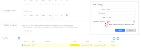

I have a RN3138 with a UPS, plugged in USB. This is fine. Everything is working as expected there. I have another server plugged into the same UPS that I would like to shut down when on battery ...

The name of the remote UPS before the @ must match the name displayed in the ReadyNAS config page. In my case, UPS1(autogenerated). It may be different foe someone else.

I cannot find any documentation on what "Enable network monitoring of attached UPS" does.
The NAS uses NUT (network ups tools) to monitor a USB-connected NAS.
To monitor it over the network, you'd need to install NUT software on the server - if it is running Windows, that would be an old beta software package. https://networkupstools.org/download.html
Then you'd set up NUT on the server to connect to the NAS IP address, using monuser for the username and pass for the password.
Ideally the server and the NAS would be on the same switch (which would of course also need to be protected by the UPS). Upstream routers or switches wouldn't need to be protected.
