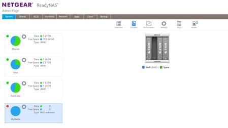

Hi, My RNAS 104 is used mostly for back up so I have all 4 bays filled with each as JBOD. I swapped a 1TB drive for a 2TB drive and whilst copying files I started to get a "Remove inactive volume to...

Hi, My RNAS 104 is used mostly for back up so I have all 4 bays filled with each as JBOD. I swapped a 1TB drive for a 2TB drive and whilst copying files I started to get a "Remove inactive volume to use disk 2"
I removed the drive and rebooted but the system still shows 4 volumes with only 3 HDDs, see pic.
Looking at this, it looks like MyMedia was the volume name that you choose for the 2 TB disk you removed. Or maybe it was the volume name on the original 1 TB drive???

- click on the volume settings wheel for MyMedia and destroy it.
Note that if you want to replace the disk in a jbod volume with a larger one, you can't just "swap it". You need to destroy the old volume first. Then insert the larger disk, and create a new volume, recreate the shares, and any backup jobs.

Not sure what you will see when you re-insert the new 2 TB drive after step 1. If you see a volume on the new 2 TB drive (or one with RAID unknown), then delete it using the settings wheel.
Either way, select the new disk in the center pane, and select format. After the format, create a new jbod volume for that disk.

If you think there is a chance you'll need to re-install the old drive, you can EXPORT it instead of Destroying it. If the replacement has the same volume name or any shares with the same name, you will have to export it before you import the old one back.
