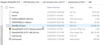

There are the files I used, including 2 OS6 files, and I edited the xml to include them in the USB creator inventory

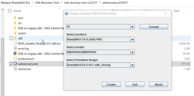

Here is the creator GUI showing the option I added (PRO)

- StephenBJun 24, 2022Guru - Experienced User
Does this seem correct for creating a v6.0 recovery USB drive?
No. Prep4tor6 shouldn't be there at all. And you should be using the OS 4.2 recovery tool with an OS 6 image. You shouldn't need to modify any XML.
