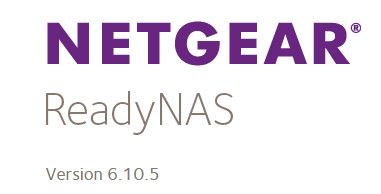

RNDU4000 after update from FW4 to FW6 extremely slow - any suggestions/solutions?
Hi All, I´m new here and would really appreciate your help and maybe some hints. Got me a used Netgear RNDU4000 (ReadyNAS Ultra 4) from a friend with FW4.2.31 installed. After reading a bit I th...

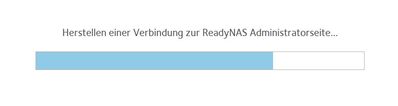

Cannot confirm that resync speeded up really but seems to be that the admin interface keeps alive now. Before doubling the RAM it happend to be that the admin page was not reacheable any more and "raidar" was unable to find the NAS after a while.

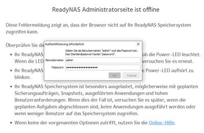

Unfortunatelly still the same:
After finishing re-sync in the morning NAS is offline and not reacheable. The loading process takes minutes and then no access possible.
So, in the end the doubling of RAM from 1GB -> 2GB was not really helpful and upgrade to FW6 is a fiasko.
