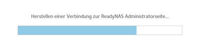

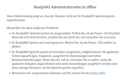

Cannot confirm that resync speeded up really but seems to be that the admin interface keeps alive now. Before doubling the RAM it happend to be that the admin page was not reacheable any more and "raidar" was unable to find the NAS after a while.

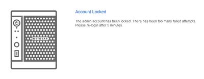

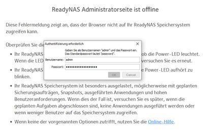

Unfortunatelly still the same:
After finishing re-sync in the morning NAS is offline and not reacheable. The loading process takes minutes and then no access possible.
So, in the end the doubling of RAM from 1GB -> 2GB was not really helpful and upgrade to FW6 is a fiasko.
Unable to work with this unreliable device and lots of spare time wasted :-(- Andy_BerlinJul 08, 2021Tutor
