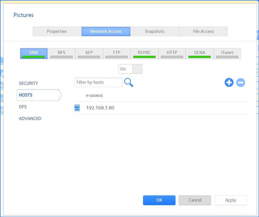

Rsync not working between RN528X and RN212
Trying to execute a backup from the Pictures share of RN528X to the Pictures share of the RN212. Rsync is enabled in the system settings, and Rsync is enabled specifically on the Pictures folder...
jimk1963
Sep 09, 2023Virtuoso
- jimk1963Sep 09, 2023Virtuoso
Forgot to mention, I also tried:
- Entering username/password (admin/xxxxxxxxxx), didn't help - and the NTGR documentation advises against it
- Instead of Destination IP address, tried "Discover" button which found "RN212:local" instance. Didn't help
- Added the source IP address to the Destination share Network settings. Didn't help
- Tried "remote: Windows/NAS (Timestamp)" (by mistake actually), and when I do this, selecting "Browse" actually shows me all the Pictures sub-folders perfectly. However, this protocol also fails when executing a backup.
- Tried manually typing "Pictures" in the Destination Share location, didn't help. Also tried "Pictures/", didn't help.
- StephenBSep 09, 2023Guru - Experienced User
Is rsync enabled for the share on the remote NAS?
Yes:
"Rsync is enabled in the system settings, and Rsync is enabled specifically on the Pictures folders of both NAS's as well (right click on Pictures folder, select Settings, click on Network tab, make sure Rsync is ON and Read/Write is selected)."
- schumakuSep 09, 2023Guru - Experienced User
rsycn is a protocol different than SMB, authenticating is required. But before, the rsync server on the destination NAS must be enabled and configured. Once done so, start with the [Test Connection] offered - for some reasons, it exists.
- Per NTGR, authentication is not required:
- Yes the destination NAS is enabled for RSYNC, as noted in the original post:
- Also as noted in the original post, RSYNC works fine from RN528 to RN424 as long as I choose a specific destination share ("RN212-Backup"). And - no authenticating is used (username/password are left blank). And - as posted earlier, I did try using authentication, made no difference. Finally, that "RN212-Backup" share has exactly the same settings as the Pictures share on the RN212, as far as I can tell from going through every settings screen.
- And again, RN528-to-RN424 fails same as RN528-to-RN212 if I choose "Pictures" share as the destination folder (same as RN212).
Seems like there's some kind of Permissions issue or other issue with trying to backup to the "Pictures" shares on either NAS.
Forgot to add - yes, I use the Test Connection feature every time. However, caveat emptor. For example:
- with RSYNC protocol, Test Connection fails
- with Windows/NAS protocol, Test Connection is successful. But the actual backup fails anyway
After a night's sleep, and a complete walk-through of all settings again, the source NAS (RN528X) on 192.168.1.80 was mis-typed in the destination NAS RSYNC settings as "192.168.0.80". Argh.
Working normally now. Thanks for the assistance.
