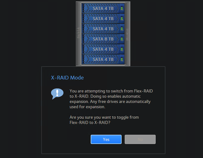

Upgrading disks in a RN316
I have a RN316 populated with Seagate 4TB drives. Drives are getting really old now, and finally stating to fail after 6+ years of power on time. 🙂 I had disk 4 fail, and I replaced it with a 8...

Hello StephenB ,
I don't mind about not being able to switch back to Flex RAID. I figure I'll have more than ample space for a LONG time after doubling the disk's capacity. I don't see me needing to do that again.

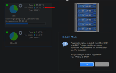

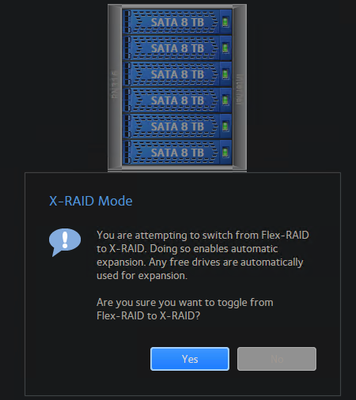

Ok, this is really weird.
I decided to just replace the 4TB drives with 8TB drives, and leave X-RAID off for the time being, so I could watch the rebuilding process when I flipped it to X-RAID.
As you can see, all 8TB drives are installed, and FlexRAID is still active:- LaserbaitMar 07, 2023Luminary
However, as soon as it rebuilt the 6th/last 8TB drive on the shelf, it automatically started rebuilding again. It incorporated the new space. The "Free Space" on volume "Data" was about 6TB when I last looked at it. Now, it's about 24TB! Still on Flex-RAID:
