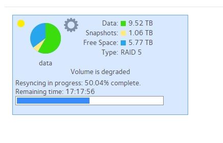

Okay I put that one drive back in and was able to select Format as soon as I selected it and then typed in "FORMAT" the display changed to this
Already showing it at 50%, I am planning on letting it run till it's done, Is that okay??
- StephenBOct 18, 2022Guru - Experienced User
Yes, exactly correct.

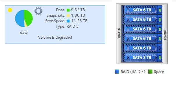

Okay, that one synced and all next question I put disc number 5 Now. I had to tell it to format like I did for the other HDrive not it has been about 10 min and it is not syncing and the drive in the RAID does not have a green light it has this
See the space to the right is not lite up green. Any help is appreciated
