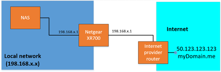

VPN is preventing normal access to my local network
I have the following network topology: Local network with a NAS (192.168.x.x) <--> Netgear XR700 Router <--> Internet provider router (static: 50.123.123.123) Also I have my private domain "myDomai...

Are you saying that simply enabling the VPN service on your XR700 router resulted in my.domain.me not working?
If this is the case - OpenVPN requires that the XR700 be configured as a router, and not an AP. Was it configured as a router before you configured OpenVPN?
Normally if the WAN address of the XR router is 192.168.1.x then the LAN addresses would be something different than 192.168.1.x. Most Netgear routers would automatically fail over to 10.0.0.x LAN addresses if they detect the WAN address is 192.168.1.x.
Also, 443 and the tun/tap ports both need to be forwarded from the ISP router to the XR700, and then 443 needs to be forwarded again to the NAS. It is best to reserve the XR700's WAN IP in the ISP router, and also to reserve the NAS IP address in the XR700.
Also, how is myDomain.me associated with your ISP's router IP address? Is this done with a DDNS service in the ISP router? Or is this done some other way? Have you checked that myDomain.me still reaches your router's IP? For instance, by entering ping myDomain.me, and then checking that the WAN IP address is the same address used by your ISP router?
Or are you saying that this is happening on the laptop when you are connected using openvpn?
BTW, there is no risk in posting 192.168.x.x (or other private address ranges) publicly, since they cannot be used for routing.
