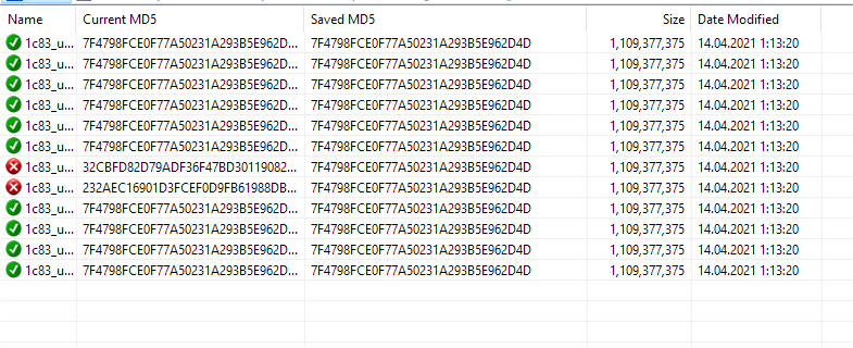

I got a checksum error message in the backup software.
I was check disks and found on one many bad sectors. (using HDAT2 software).
NetGear was no errors in GUI.

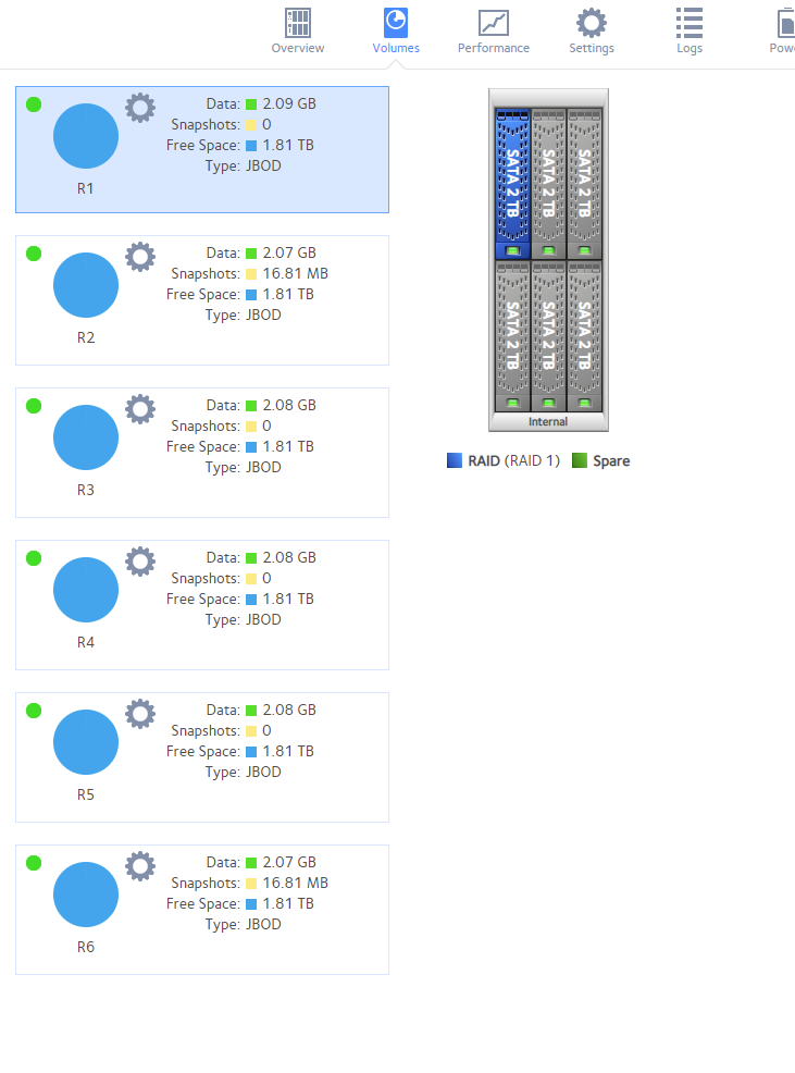

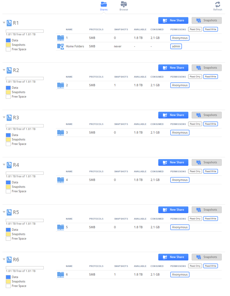

    I have partitioned jbod raid drives into each drive. RAID number 4 checksum error.
    That's a clear indication that your issue is either linked to that disk or to that slot.  The next step is to figure out which.
    I suggest destroying RAID 1,2,5,6, and removing those disks.  Then power down the NAS, and swap RAID 3 and RAID 4.  Power up and re-run the test on both volumes.  That will let you know if the problem is linked to the disk or the slot.
    If the problem disappears on both disks, then it could be power-related.  You can confirm that by adding the removed disks back one at a time, and see when the problem starts happening again.

        Checksum

    I have partitioned jbod raid drives into each drive. RAID number 4 checksum error. But no errors in dmesg.
    Every 2.0s: cat /proc/mdstat                                                             Fri Jun  4 11:30:16 2021
    Personalities : [raid0] [raid1] [raid10] [raid6] [raid5] [raid4]
    md122 : active raid1 sdf3[0]
          1948663808 blocks super 1.2 [1/1] [U]
    md123 : active raid1 sde3[0]
    md124 : active raid1 sdd3[0]
    md125 : active raid1 sdc3[0]
    md126 : active raid1 sdb3[0]
    md127 : active raid1 sda3[0]
    md1 : active raid10 sda2[0] sdf2[5] sde2[4] sdd2[3] sdc2[2] sdb2[1]
          1566720 blocks super 1.2 512K chunks 2 near-copies [6/6] [UUUUUU]
    md0 : active raid1 sdf1[6] sdb1[2](S) sdc1[3](S) sdd1[4](S) sde1[5](S) sda1[1]
          4190208 blocks super 1.2 [2/2] [UU]
    unused devices: <none>
    Error on SHARE 4 (R4)JBODshares
