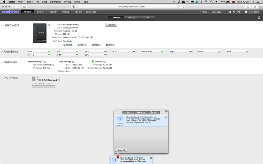

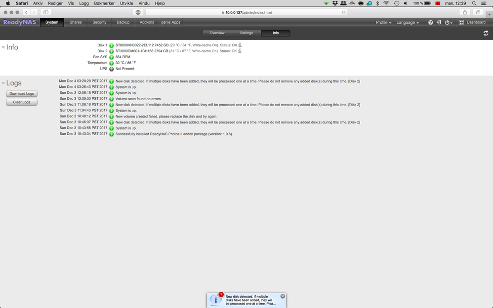

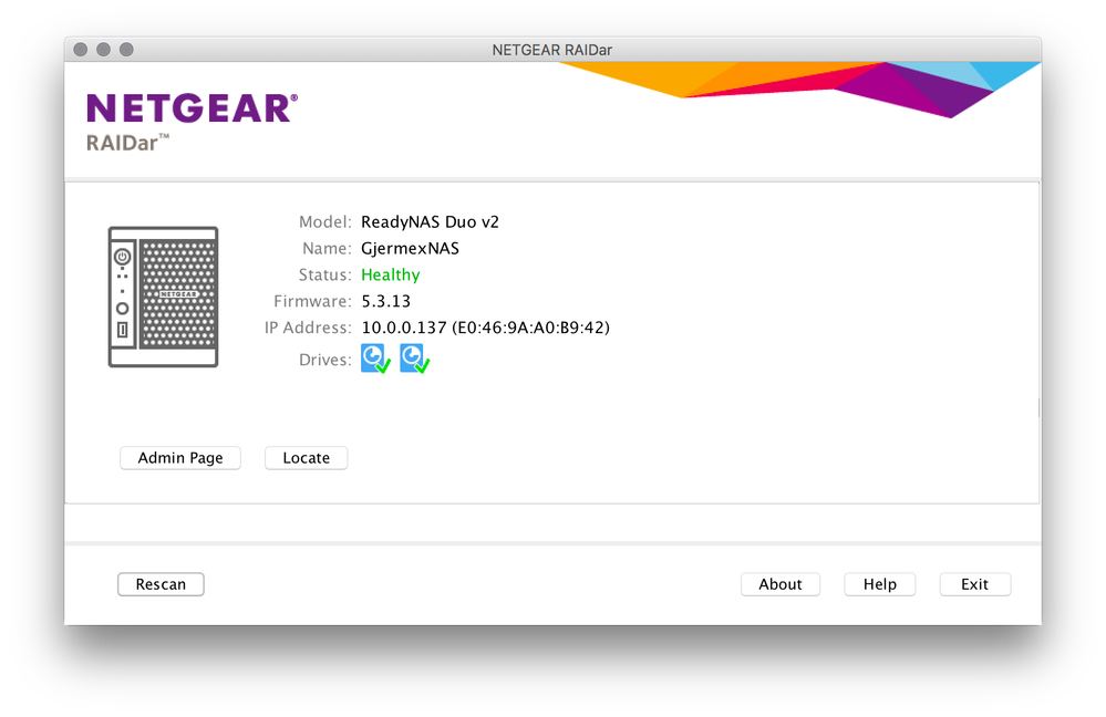

The erase process is completed.
I hot-inserted the disk, and once again both the web ui and Raidar identifies the disk, and gives me the green lights.
Still no Volume D.
I've tried taking out the disk and putting it back in, with the unit running. This gives the same result.
After that, I tried rebooting the device with both disks inserted, but I still only have one volume.
Here are some photos to document my system status.Web UI identifies the hot-inserted diskBoth disks seem okRaidar gives me the green lights
- StephenBDec 04, 2017Guru - Experienced User
The log snippet does say that the new volume creation failed, but it doesn't say how. Try downloading the full log zip file, and see if you can find something more helpful in there.
