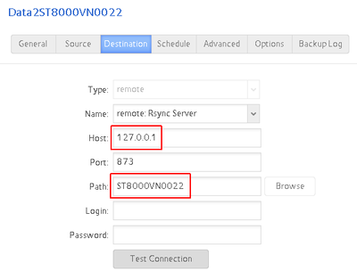

As destination, I point the NAS to the remote rsync server on 127.0.0.1 (which is essentially the local machine accessing the USB drive via rsync):
I exclude the /admin/snapshot directory, because this will confuse the NTFS filesystem and set the --delete option to remove remote files that don't exist locally anymore:
So far, so good.

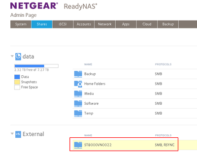

This backup seems to be bound to the share HDS5C3020ALA632 for the destination. Now assume, that drive is not connected but I accidentially hit the backup button on the NAS. I hope, in this case it is NOT writing to the OS partition but rather failing the operation in the first place as any sane person (and all the Linux OSes I have worked with) would do.
Am I right? Thanks again for your patience. I'm getting a bit paranoid after three sleepless nights. :smileywink:

I've not tried it, but I think the answer may be that it will write to the OS partition in that case. I know rsync can't tell the difference when a directory that's intended as a mount point actually has something mounted to it or doesn't, but does somehting in the NAS unique software check first?
The screen grabs are there. A moderator has to approve them, but that's obviously already taken place.
I think this is worth some time with my "sandbox" NAS, so I'll give it a try some time this weekend if I have the time. You may have more fully explained why so many have issues with a too full OS partition. We've seen instances that were clearly related to an unmounted USB drive, but I never thought about the backup button being a trigger.
Or, if you want to try it, do so with a share that has very little in it, so the OS partition won't fill and you can still get in with SSH and check the content of the mount point with nothing mounted and delete anything that is there.

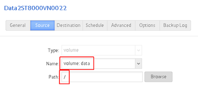

On a sidenote: I eventually came up with a quite elegant (OK, translation: not totally clumsy) way of backing up the entire data volume of the NAS with one single backup job. So assume a big disk is attached as ST8000VN0022 via USB, rsync enabled:
Let's then declare volume:data as the rsync source and add the slash "/" to the path, so there is no useless directory "data" created at the target:
The rsync target is of course the external HDD on localhost:
I had to enable the "Multiple Files Systems" option (otherwise the shares underneath "data" weren't included in the backup) and add "home/admin/snapshot" etc. to the rsync ignore list, because I had btrfs and smart snapshots enabled for user's homes:
My dry test on a blank HDD worked well, all directories&files equal. So the big question is: Am I missing something totally obvious here or is this a viable way to backup the contents of a ReadyNAS to an external disk of at least equal size?
