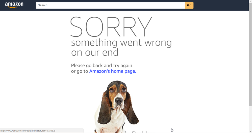

I've been using Amazon Drive to back up my ReadyNas for over a year. I checked Amazon to make sure that everything was backed up, but saw that the backups stopped a few weeks ago. So, I went on my ad...
