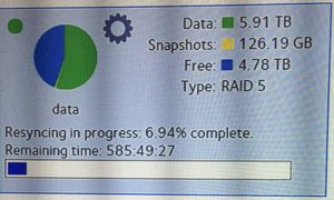

Two day ago I delete a bond network and my ReadyNas RN104 Crash again. I was running 6.4.2 when I have my first crash that was a few week ago Nas was very slow. Then I was told to upgrade FW to 6.5.0...
