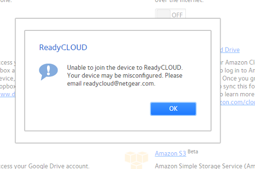

Now I have another issue. When I try to "Join" my self to the ReadyCloud (I have a valid MyNetGear account) I get:this: https://i.gyazo.com/5c501a9cf1356daa52237802cdca7ddd.png
