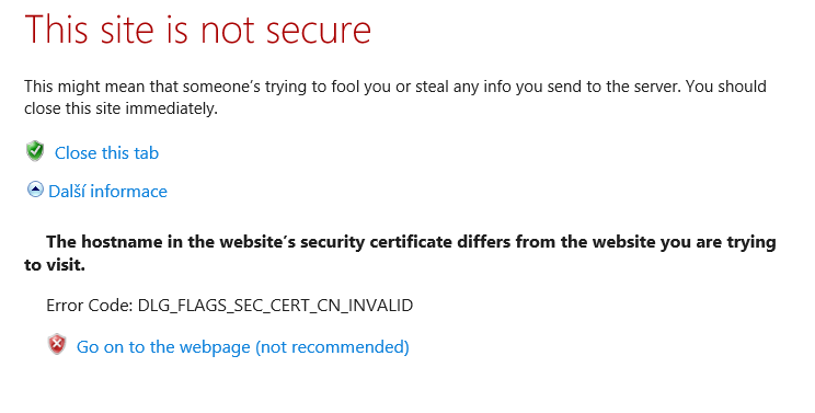

You wrote about reinstall OS the NAS. Do you mean "Perform Factory Default"? It means, that all data on harddisks will be deleted. It's crazy, I don't have enough free place for backup all data which are on the NAS. All computers at home have almost full disks and my second NAS (not Netgear) is also almost full. Or do you mean something other? What?
One more thing, in Internet Explorer I have different error massage, pls see below (I don't know if it means the save trouble as in Chrome, but there is possibility skip this with "Go on the webpage"
