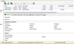

iSCSI strange behavior with random write (utorrent)
Hello, I'm using RND6 Pro with E7300/4Gb/6*2Tb WD Black (x-raid/raid5 mode) and windows 8.1 x64 as client. all NICs are Gigabit. One NIC at client and one NIC at RND. Later I had FW 4.2.27 and one...
