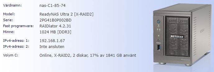

Lost contact with NAS after upgrading Windows 10
I have recently upgraded Windows 10 on my computer and after the upgrade I appear to have lost contact with the NAS. When I click "Browse" in RAIDar I get the following error message (translated to E...
- Oct 23, 2018
Options include
- Installing the SMB 1.0 client on your Windows system. You do this by going into "turn windows features on or off"
- Installing the NFS client in Windows and enable NFS in the NAS.
- Converting your NAS to run OS-6. This is unsupported by Netgear, but would give you SMB 3.0

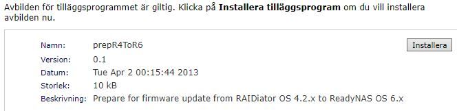

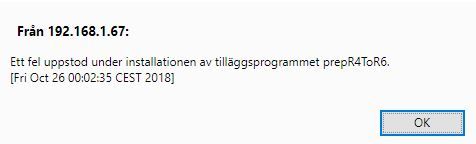

So, I managed to download PREP4TOR6_0.1-x86.bin, but when I tried to install it as an add-on, I got an error message:
Any ideas?
- DisNASterOct 25, 2018Aspirant
I got the message that the image was valid:
And also a message saying that an error occured during installation of add-on program prepR4ToR6
- mdgmOct 25, 2018Virtuoso
Installing the Prep add-on is not essential as if you have physical access to the device when the system comes up in a weird state you can then power down and do a factory default using the boot menu.

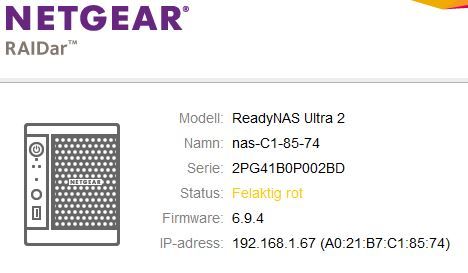

- DisNASterOct 26, 2018Aspirant
It appears the old User ID and password does not work any longer. Any suggestions?
As far as I can tell from the progress so far, the NAS appears to be up and running OS 6.9.4. Further testing will tell. A user manual for 6.9.4 would help. Does anyone know if there is such a manual, and if so, where to find it?

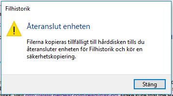

Excellent, now I have a manual. When trying to configure backup on one of my computer i get an error message: "Reconnect the unit"
How do I reconnect the unit?
- StephenBOct 27, 2018Guru - Experienced User
Can you simply access the NAS shares from file explorer? This is to confirm setup.

Yes, I can access the NAS shares from file explorer, so it appears the setup is ok.
I have finished the first 50 pages of the software manual. I will finish the rest and look through the backup faq to see if I can find out why backup does not work.
