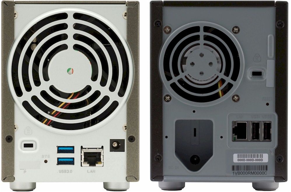

For others considering purchasing used, look at the picture of the rear of the Duo in question. If the fan is the full width of the chassis, it's a "real" V2. If the fan is smaller, and there is an depression where the power plugs in, it's a V1. Even on poor quality photos, these can usually be picked out.

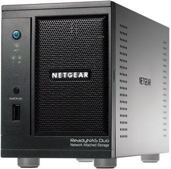

- StephenBDec 21, 2020Guru - Experienced User
Here's the front of the original Duo (v1). Note it just says "ReadyNAS Duo". The v2 looks the same from the front, except it says "Readynas Duo v2". The finish of the v1 is black - the v2 is more gray than black, but that might not be picked up in a photo.
The backs are definitely different, so if a rear photo is included it is easy to see which it is. Here is a side-by-side that compares the v2 back panel with the v1. The v1 (original) Duo is on the right.
