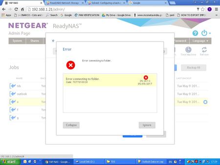

Not able to configure Ready-NAS 204
Hi , I have already configure NAS once , after my server crash I need to re-setup my NAS . Hense whenever I try to configure it , test connection give me "Code:7077010020" this error. Can some ...

- bhaskarspurMay 09, 2017Aspirant
Hi ,
I have check my drive and folder sharing from other pc , it's comletely accessible and editable even I try to configure one task from other pc , it works fine from other pc but can's solve my server issue.
Here how I configure one task in NAS.
- StephenBMay 10, 2017Guru - Experienced User
Does using the PC's IP address instead of the hostname work? Is the NAS set to the same workgroup as the PC?
There is a guide here that might be helpful: https://kb.netgear.com/29766/How-do-I-back-up-data-from-a-Windows-SMB-share-to-a-ReadyNAS-OS-6-system
