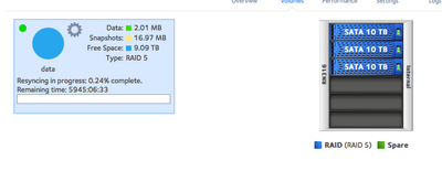

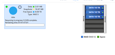

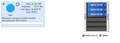

populating a RN316 with Seagate 10tb drives
Trying to fully populate the RN316 with 6 x Seagate ST10000NE0004 10TB drives i thought one at a time was the best way? it had 2 4TB drives installed swapped out bay one with first 10TB drive all well swapped out bay 2 resync took 24hrs but all good installed 3rd 10tb drive it is reshaping data ok all good but it is now showing 7493 hours 312 days till finnish it keeps going up by the way at this rate by the time i get the other discs installed the warranties will have run out any ideas any one
