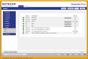

Pro 6 on 4.2.30 suddenly reported Volume dead
Hi All, I'm at a complete loss as the current issue I'm experiencing is unlike anything I can lookup. Any help or ideas would greatly greatly be appreciated as from what I can tell the data is there...

The Pro 6 isn't responding this morning as I can't turn features on or off. More like I can turn it on but it will not stay on. I suspect that maybe I removed up too many items I shouldn't have touched on the log file and its not re-creating missing files (could tie to why things aren't staying on and the option "STATUS --> Logs" is completely clear and doesn't seem to update itself.
Any ideas as to what may have happened or how I can put some of these back in? I tried to reinstall the firmware 4.2.30 but it wouldn't allow me to as the error message is "Update File is not valid for this architecture". And I can't SSH anymore, nor can I add the add-on because I get the same error
