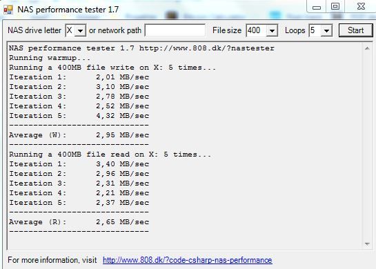

I have the stock 256 mb installed, and when i copy large files, the copy process pauses every 100 mb. Please se this video. I copy a 1 Gb file from my computer to the NAS. It copys ca. 100 mb and then pauses, then copy another 100 mb, and then pauses etc. all the way through the copy process. Why is that, and what can i do to get rid of the pauses ?

This could be more about robocopy's buffering than the NAS.
Can you try Nastester and tell us what speed you see? http://www.808.dk/?code-csharp-nas-performance

The NAS testprogram says that average write is 2 mb/sec and average read is 3 mb/sec.
- MikkelDKMar 13, 2018Aspirant
Here is the detailed performance
- StephenBMar 14, 2018Guru - Experienced User
Again, you are using an 11-year old NAS design. Netgear stopped manufacturing this model in 2011. Any new NAS will give you much better performance. The RN210 series is the current Netgear entry-level NAS, and it is capable of 100 MB/s throughput.
Thanks for the NAStester benchmark. It shows that either something is off with the NAS itself, or something is wrong with your network.
Can you give us some information on the network path between the NAS and the PC? Please let us know if it includes powerline or wifi links, and also the speed of each ethernet link.
Also download the log zip file from the admin web UI, and look at the disk health in disk_smart.log and the network statistics in network_settings.log
