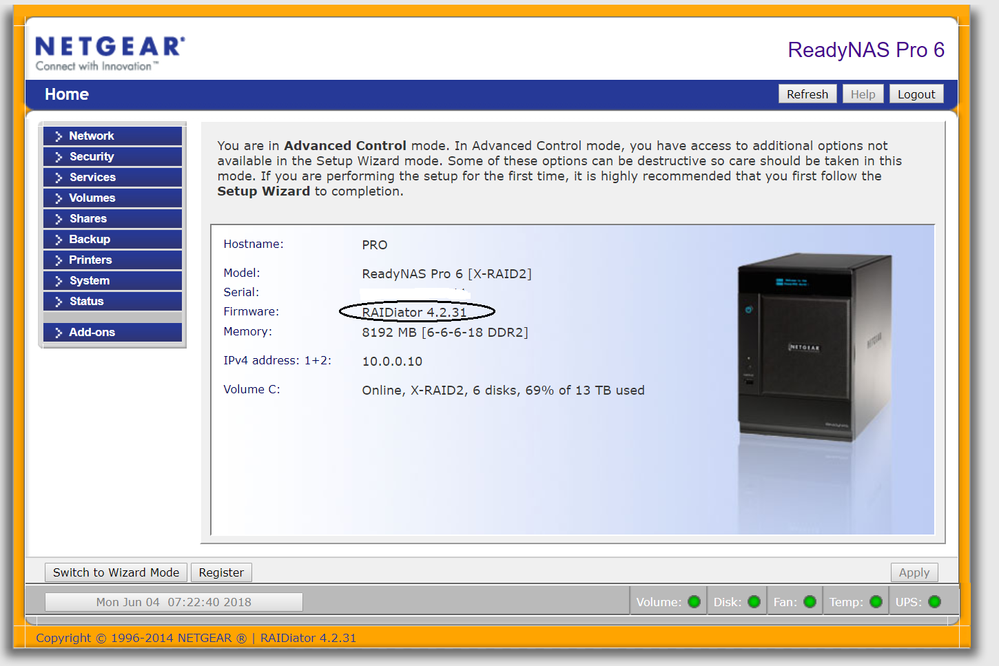

Just followed your instructions, and got to the NAS admin page but can't see the firmware version anywhere on that page, where would I find it?
- StephenBJun 04, 2018Guru - Experienced User
If you are running 4.1.6 firmware, then you have a v1 (sparc-based), not a v2 (arm-based). The labels are confusing, and many v1 owners do mistakenly believe they have a v2.
With a v1, you'll find the firmware on the home page as shown below (my screenshot is from a 4.2 system, but the layout is the same).
If you do have a v2 NAS, then you'll be seeing a very different screen (and will be running 5.x.x firmware, not 4.1.x). You'll see the dashboard overview page (which shows the current firmware) on page 12 of the v2 software manual here: http://www.downloads.netgear.com/files/GDC/READYNAS%20ARM-PLATFORM%20(DUO%20V2,%20NV+%20V2)/RAIDiator%205.3%20SW%20Manual_5Sep12.pdf
