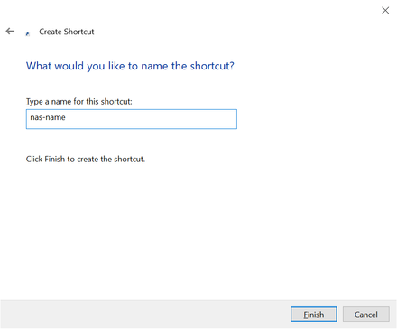

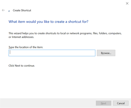

Here's the method using a desktop shortcut:
- right-click on an empty spot on your desktop
- Select New->shortcut
- Enter \\nas-name in the location field (being careful to use the correct slash)
- Click next
- Enter the name that you want for the shortcut
- Click Finish
This will put a shortcut icon on your desktop. Clicking on the shortcut will open up file explorer, and show you the folders on the NAS.

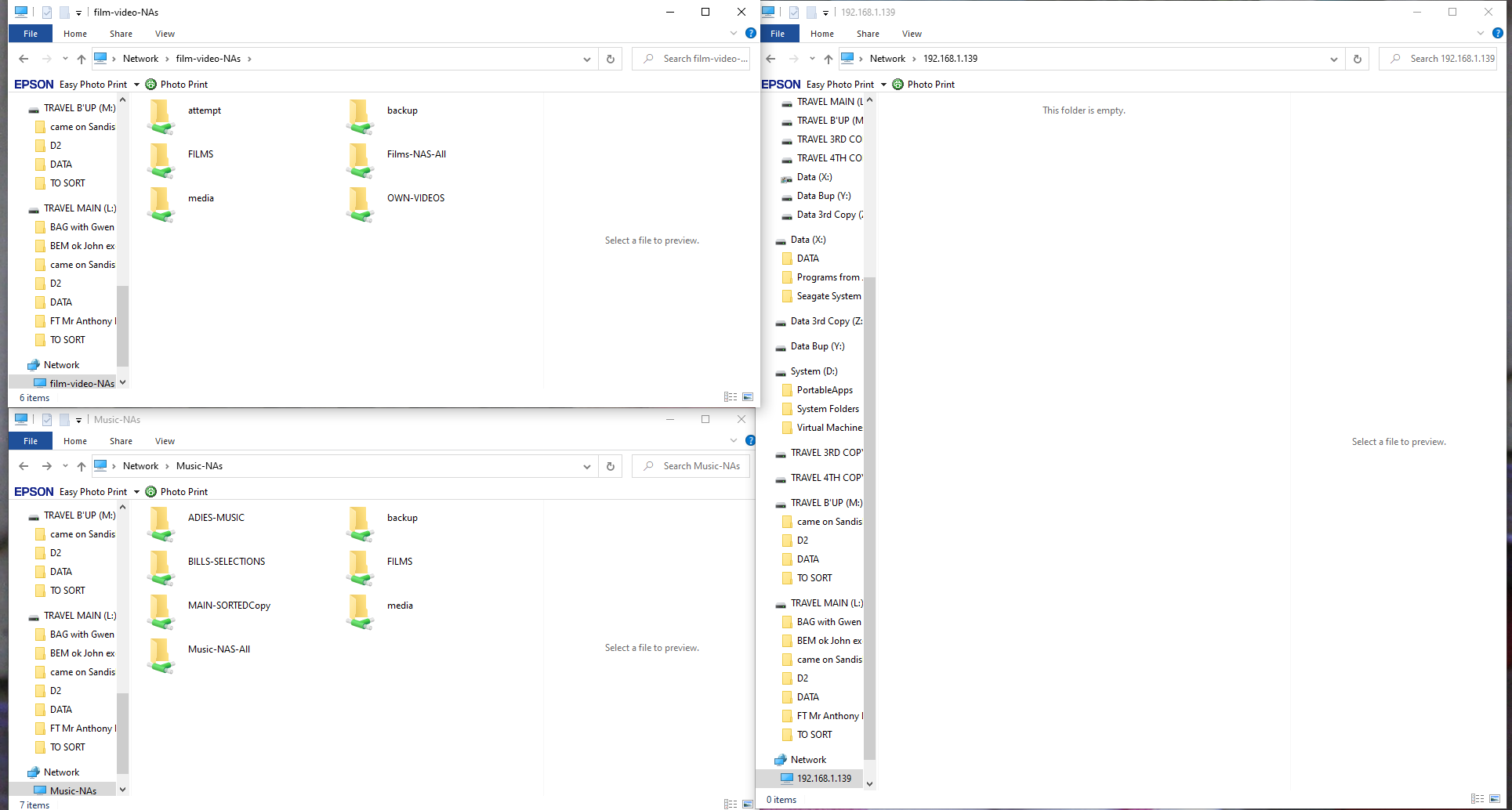

Hi, When trying to delete the 'new' share i created , it was created in the Browser ( web?) Radiator access to the NAS. I called it attempt. Its through the MAin NAS access in the browser, I have to enter for either NAs //192/168/1/.../admin in the browser top bar, and then it asks for the NAs username and password. This used to be easy, but I have the last few days had a few issues with this as well, it can take 5 or 8 attempts of enetering the admin, and password before it allows access to radiator... Is there a way to correct that, or make better??
I can still access either NAs using the explorer bar, and the format you said of //Nas-name see attached image. The folders i was speaking of were, that originally i seem to remember i had a top level Folder in each NAS, in the Films NAS, One Films-NAS-ALL, The otherin the Music NAS, Music-NAS-All and inside were the other folders as sub folders. I dont remember moving them out, so seperate, but may have done so that each was accessible without going through the above two 'all' folders.
Now on Films NAS, Attempt,( I created and want to delete, but when i try in the Browser Radiator it will not do so, I tried selecting and deleteing several times). & Films-NAS-ALL, are empty, media and backup seem to have a mixture of folders in them, including PVR data ( empty), library,(empty) and other folders Bittorrent (empty), music ( empty), pictures ( empty)etc. there is also a file called smb servers, and javasetup ( possibly from last attempt to update software when had to instal java), I would guess some could be deleted now, especially if starting setup again to EVO, although it may still pick up where access last stopped 2 years back.
Music NAS , again Music-NAS-All is empty ( as i said above i may have moved nested folders out and just dont remeber, but it was once a top level folder). And it again has the Media folder( sub folders Bittorrent, Music, Pictures, Videos, all empty...so could clear of not required?), ) and backup folder ( inside Library,( just a file mlibrary)inside pvrdata,(empty) and Thumbs( few bits old rubbish!)
So a lot could be removed as empty or not needed?
I have while in Radiator for the Films NAS tried delete several times the Attempt etc.
NOW I can access both NAs share folders using \\nas-name BUT if i go back to using the \\Ip-address, for both NAS that now comes up as 'this folder is empty????? See image I did try closing the film one opened using \\nas-name but still using the Ip address option it came up as empty. I'm only a simples Guy, so getting a little bemused why entry options keep moving so.

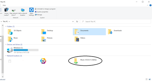

The other option is to add the shares to File Explorer as network locations. That would look something like this:
You'd see this view by clicking on "this PC" in the left pane of file explorer.
The process is similar to creating a shortcut. You begin by clicking on "add a network location" (shown at the top of my screenshot). Then enter \\nas-name\sharename, and enter whatever name you want for the location. Note you can't just add \\nas-name as a network location, you have to enter a sharename.
