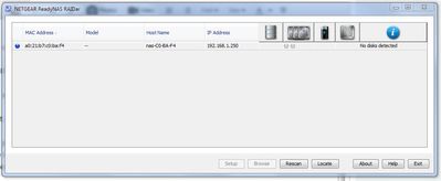

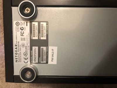

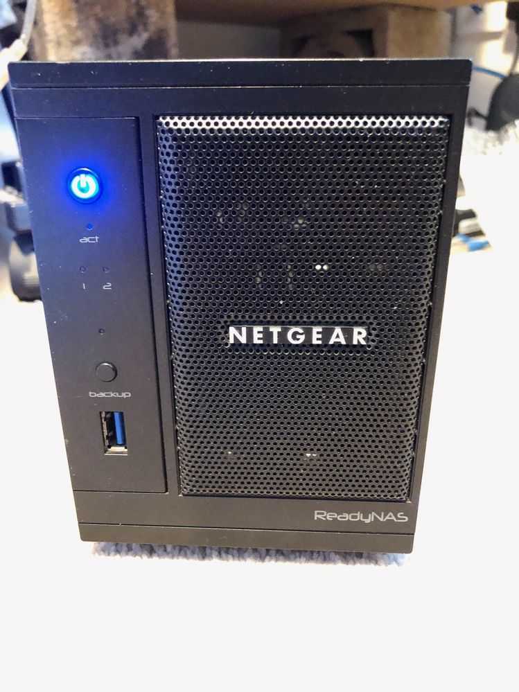

My ReadyNAS Model Name: RNDP200U (Model No: RND-2A) is not reading the two disks.
Using Raidar 4.3.0.
X-Raid2 Setup - I believe as I did not go into any complex setup procedure. It would work with one disk in and hot swapable, without issue in the past. I would take one of the disk on holiday for security.
Disks 2 x 3TB Seagate Barracuda XT
Symptoms:
1. Raidar finds the NAS (See Attached) dut does not detect disks.
2. I cannot connect to it via the web interface, I get a time out error after a short while.
3. Prior to failure, the disks in Raidar were shown as green(No faults). So I am assuming the disks are ok?
4. I initially suspected a fan or power supply issue, as the LED on the power supply was flickering as I disk were inserted and there was a odd noise (cycling) as the disks tried to spin I assume. This noise was the original symptom before failure. I thought it might have been the fan so cleaned the fan and cabinet. The power supply was changed with a new one.
5. The NAS itself cannot be shut down by double clicking on the power button as usual. I feel like it is not booting up properly? Could it be a failed DIMM memory?
6. I have tried another spare disk in the NAS, but does not do anything with it! Not seen by Raidar

  • StephenB's avatar
    StephenB
    AmalW wrote:
    1. I have ordered a similar NAS off ebay; RND2000v2. If I plug the old drives in the new NAS, will it work? Or will it erase the data?
    It will not work - the nas either won't boot, or it will erase the data.
    If you do need to off-load the data, you can connect one of the disks to a Windows PC (via SATA or a USB adapter/dock), and use R-linux for Windows to access the files. https://www.r-studio.com/free-linux-recovery/
    It could be a disk failure (one which might be hanging the SATA backplane).  I suggest powering down, and testing the disks in a Windows PC with Seatools (again, they can be connected either via SATA or a USB adapter/dock).

  • Since you had no luck with (I am assuming a known good) scratch drive, then the likely problems are a bad SATA subsystem and a bad internal power subsystem (converts the power brick 12V to the required internal voltages).  Neither of those is repairable.
    Unfortunately, the NAS you chose to purchase is very much not like your old one.  It has a different processor and runs a different version of the OS.  Compatible desktop units would be the Ultra2, Ultra2Plus (which is what you have), Pro2, Ultra4, Ultra4Plus, Pro4, Ultra6, Ultra6Plus, Pro6, ProBE, and Pro Pioneer.  The NVX is also  compatible, but not really a good choice because of it's 32-bit archetecture.  There are also some rack-mount models.  Many of those for sale have already been converted to run OS6, so you'd have to re-convert back to OS4.2.31 to mount your volume, assumning it's still intact and not damaged by whatever took out the NAS chassis.
    Moving forward with recovery outside the NAS is probably your best choice.
