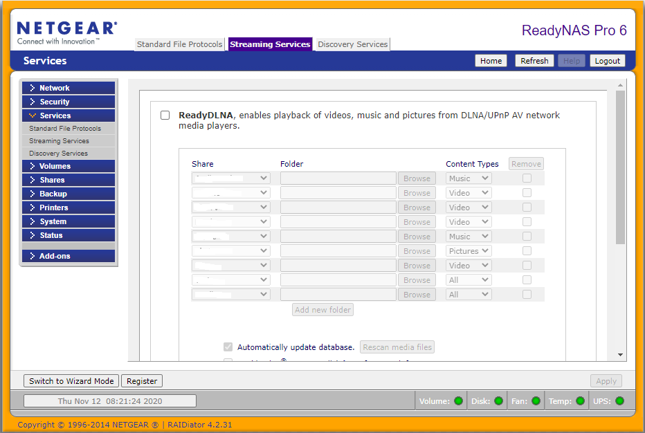

- StephenBGuru - Experienced User
Grunchy wrote:
"ReadyDLNA" add-on seems to be working when I first install it except there's no way to add a share or configure media streaming at all,
ReadyDLNA is a built-in streaming service, it is not an add-on. What are you installing and where did you find it?
You enable the service and configure the media shares here:
- GrunchyAspirant
No, I don't have that service unfortunately. Please see attached.
I had never seen that "Streaming Services" option which is why I did the add-on.
This is the download I got, was it a mistake? "x86 (Pro/NVX/Ultra/Ultra Plus): Latest ReadyDLNA Update Addon Package (1.1.4)"

- mdgmVirtuoso
Streaming services were disabled on the rackmount models because it was assumed most users wouldn't use it on those models.
Install this toggle add-on: http://www.readynas.com/download/addons/x86/4.2/ToggleStreamingServices_1.0-x86.bin
Installing it once will show Streaming Services in the web admin GUI. Installing it a second time will revert that change.
