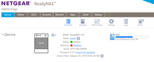

ReadyNas 104 volume expansion
Greetings! I've a ReadyNAS 104 running Firmware 6.4.1. Previously, I had four 3TB drives running on the X-RAID volume. I had approximately 8TiB with that volume (expected math). I began ...

Do you have full backup of the data? If you have, maybe you can try factory reset with all these 6TB disks inserted and create a new volume and see if that will give you the expected volume capacity.
If none, it is best you try contacting support center, this can be checked and fixed from the backend.

There was an attempt at forcing a resync to get my drive that was marked as spare unmarked.
The resync never finished (the NAS kept hanging and restarting the resync).
After the fourth freeze and seeing the resync time go back up to 120 hours again (and not wanting to try a firmware update in the middle of a resync), I finished copying off my files and factory reset.
I now see my full drive space I expect. I did firmware update as well (to hopefully prevent the aforementioned freeze).
Hopefully I'm good now.
Thanks everybody for your assistance!
