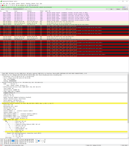

ReadyNAS DUO web interface or file shares not responding, but ping does
My (ancient) ReadyNAS Duo RND2000v2 have been working flawless for years, but all of a sudden it stopped working: It's no longer possible to access, neither from Windows. It doesn't even open the we...

- flundstrom2Oct 18, 2022Aspirant
Oddly enough, this is the third time I try to respond to your follow-up question. The first two attempts vanished into the cyberspace somewhere.
Radidar doesn't respond any firmware version at all, just that both disks are checked green.
The UDP response from the NAS to raidar's information request is
a0:21:b7:84:d1:80 NAS 192.168.0.112 fan!!1!!status=ok::descr=1630RPM
ups!!1!!status=not_present::descr=Not present
volume!!1!!status=ok::descr=Volume C: RAID Level X, Redundant; 307 GB (33%) of 921 GB used
disk!!1!!status=ok::descr=Channel 1: Seagate ST1000DM010-2EP102 931 GB, 0C/32F[Sleeping]
disk!!2!!status=ok::descr=Channel 2: Seagate ST1000DM010-2EP102 931 GB, 0C/32F[Sleeping]
model!!0!!mode=home::descr=ReadyNAS Duo::arch=nsp
Boot!!FS_CHECK!!100%
BOOT
66 1 1Or as raw data
C1BC733479FFFFFFFFF00A61303A32313A62373A38343A64313A3830094E4153093139322E3136382E302E3131320966616E21213121217374617475733D6F6B3A3A64657363723D3136333052504D0A75707321213121217374617475733D6E6F745F70726573656E743A3A64657363723D4E6F742070726573656E740A766F6C756D6521213121217374617475733D6F6B3A3A64657363723D566F6C756D6520433A2052414944204C6576656C20582C20526564756E64616E743B20333037204742202833332529206F662039323120474220757365640A6469736B21213121217374617475733D6F6B3A3A64657363723D4368616E6E656C20313A205365616761746520535431303030444D3031302D324550313032203933312047422C2030432F3332465B536C656570696E675D0A6469736B21213221217374617475733D6F6B3A3A64657363723D4368616E6E656C20323A205365616761746520535431303030444D3031302D324550313032203933312047422C2030432F3332465B536C656570696E675D0A6D6F64656C21213021216D6F64653D686F6D653A3A64657363723D52656164794E41532044756F3A3A617263683D6E73700A426F6F74212146535F434845434B2121313030250A09424F4F540A09363609310931
