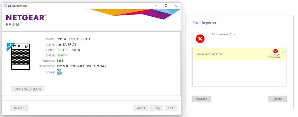

- ShaneduJul 15, 2022Tutor
I have the exact problem.
I now at the same stage as you before you had private help.
See image attached:
Do you know how to get the NAS on SDM?
I need to do this for the next step. I'm not sure how to do this.
- Marc_VJul 15, 2022NETGEAR Employee Retired
There are three options to set the NAS on SDM/SSH access.
1. Boot Menu. You can check this link for instructions.
2. If RAIDar can detect the NAS, clicking the icon for several times should allow the NAS to be set to SDM
3. If admin page is accessible, you can enable the SSH option on the Settings tab
HTH
