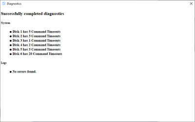

i can access the admin page and nas but nothing sending to the nas no error when i am on raidar when i check diagnostics
like you said the transfer are failing

- an issue with a disk (all show command timeouts, so hard to say which)
- a corrupted file system on the NAS
- perhaps a failing hardware supply
I suggest running a disk test as a good next step - go to the volumes page in the web ui, and click on the settings wheel. You'll see the option there. That will test all the disks (and it will take a day or so to complete). Hopefully the system won't lock up again before it finishes.
