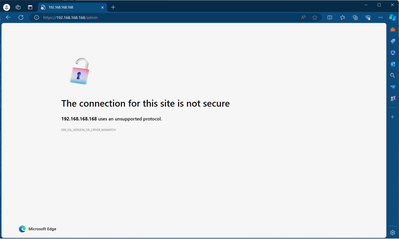

However, what happens when you browse to https://192.168.168.168/admin ?
That should get you into frontview.

When I browse to "https://192.168.168.168/admin", I still get this page...
The NAS WAS connected to my old workstation directly via ethernet cable, via LAN 1 out of the NAS and the IP address was 10.1.10.21 (It still shows that on the readout on the NAS when I put the ethernet cable into LAN 1).
Currently, the router extender has two computers hardwired, one is the office computer, the other is this workstation.
The NAS is also NOW connected to the new workstation directly via ethernet cable. I have it via LAN 2 out of the NAS and the IP address was what the RAIDar showed.
Should I try to connect via LAN 1 out of the NAS? If so, I would need to reset the manual static IP to different numbers, right?
