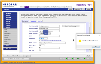

Hello,
Yes, it's year 2023, and i'm still running three ReadyNASPro 6 with RAIDiator 4.2.31 FW, but hey they are still working great and meeting my needs at the moment!
(not to mention the ReadyNAS NV+ on RAIDiator 4.1.16 FW)
Thiis issue has been on my plate for a while since 2022.
I have other apps that are working just fine using my Yahoo! mail's App passwords.
Is there certain log(s) i can use to help with troubleshooting the "Failed to contact SMTP" error?
And is there configuration file that i can check as "root" to verify the Contacts setting?

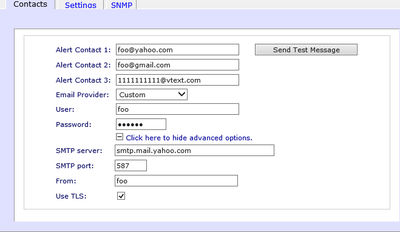

Following screenshot is showing how my Contacts setting look right now.
One thing is, is the Password field supposed to show more characters than just 6 characters?
The Yahoo! mail's App password is 16 characters, only lowercase letters (no numbers and no symbols).
Thank you.

FWIW, I suggest converting the 4.2.31 systems to OS-6.
First I would check that the NAS IP configuration is correct -
- DNS Server(s) configured
- subnet mask and gateway correctly configured
As far as logs go, you could start with msmtp.log
