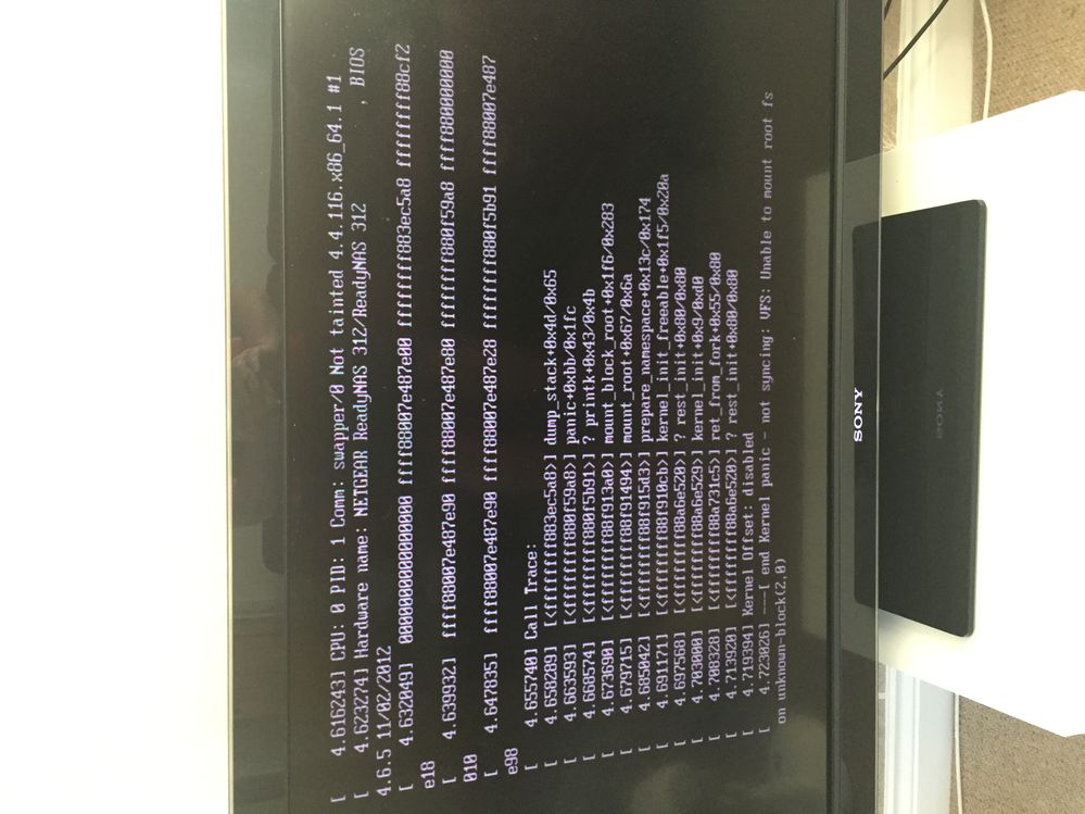

Thanks for that stephen, ok a bit of an update.
I hooked up my NAS to my tv using hdmi and have attached a picture of what it shows when trying to boot with no hard drives in and without any usb stick in ie the error as reported in my first post.
I have also tried booting with a USB stick, i think i am doing it correctly for my model, i'm holding down the backup button when turning the NAS on. The screen shows 'american megatrends' then just hangs stating boot error. Not sure if it's the usb stick so am trying another as i type.
Does the log picture help at all?

- mdgm-ntgrAug 05, 2018NETGEAR Employee Retired
Great!
That photo would suggest that the NAS was doing a normal boot (you can see the kernel version is the one for 6.9.3) not booting off your USB key on that attempt. You can see in the Call trace the words "mount_block_root". On systems with a display on the front that snippet of the Call trace would be shown.USB Boot Recovery is the solution for this particular problem. USB Boot Recovery is very rarely the solution to a problem, but in this particular case it is.
